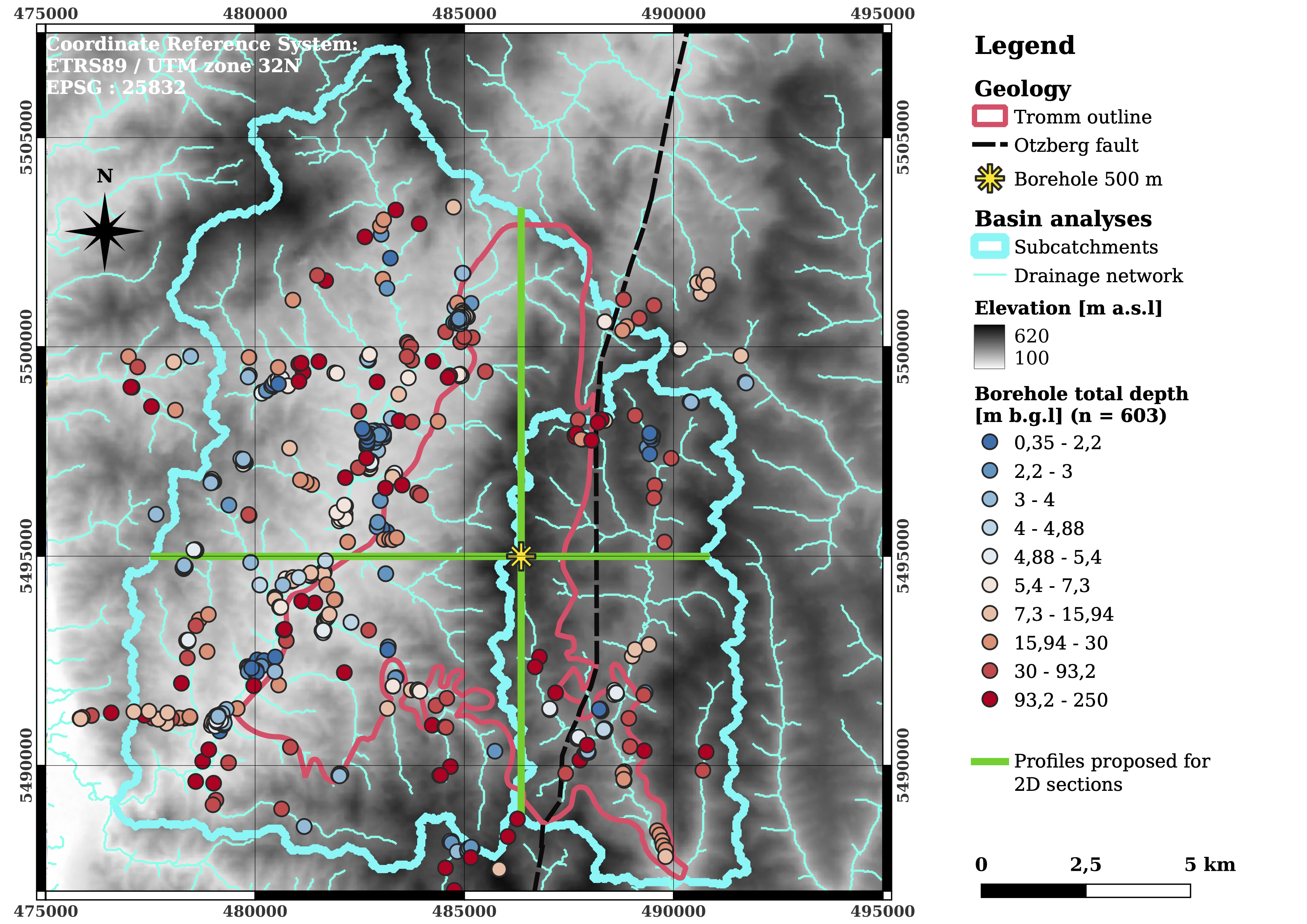

Boreholes with available logs in the subcatchments domain.
In addition, an analysis was conducted this quarter of the thickness of unconsolidated (Quaternary) deposits, including soils and alluvial and colluvial sediments overlying the rock formations. To this end, the HLNUG requested a report containing the drilling logs for 603 boreholes, which expands the existing database of 236 boreholes (see figure). Of these, 289 boreholes provide reliable data on QD thickness (i.e., the underlying rock unit). The borehole locations and depths (deciles), as well as the QD thicknesses, are presented in the figures in the report. The QD geometry is crucial for future surface hydrology modeling. An initial Kriging interpolation (spherical semivariogram, nugget = 18.9 m2) yields a rough thickness field but exhibits significant interpolation uncertainties. This result suggests that more advanced geological modeling tools, such as GemPy or Leapfrog, may be required to generate a realistic QD geometry, although preliminary tests with GemPy conducted by RTWH were unsuccessful in achieving this.
