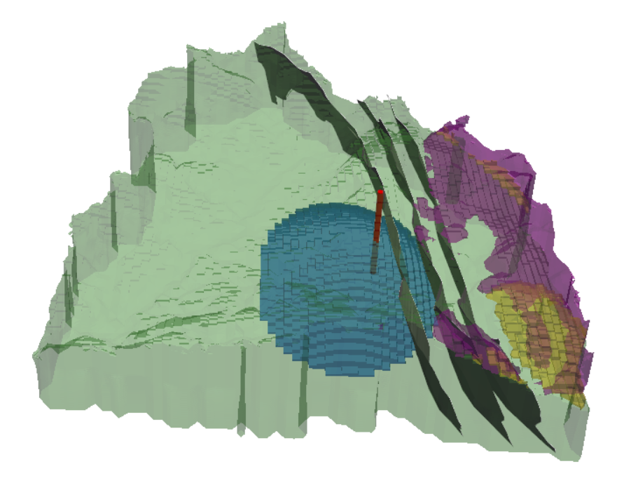

During the quarter, GIS data was used to add additional rock units to the Pre-Permian Formation. Regional maps and a digital elevation model (DEM) were used in GemGIS to extract 3D intersections; similarly, a major fault system was identified and, due to current limitations of GemPy, implemented in a highly simplified form. The lack of subsurface constraints and azimuth/dip data in the dataset complicated the modeling process, resulting in GemPy models that did not meet the desired quality standards.
In a discussion with geologist J. Grimmer, it was decided to first build a simplified structural model. The required geological information was manually extracted from a 2D cross-section drawing, interpreted by J. Grimmer, that clearly and consistently represents the granite-gneiss boundary. This base setup is called “structure model v0.1”, is shown in the figure.
Structure model v0.1
