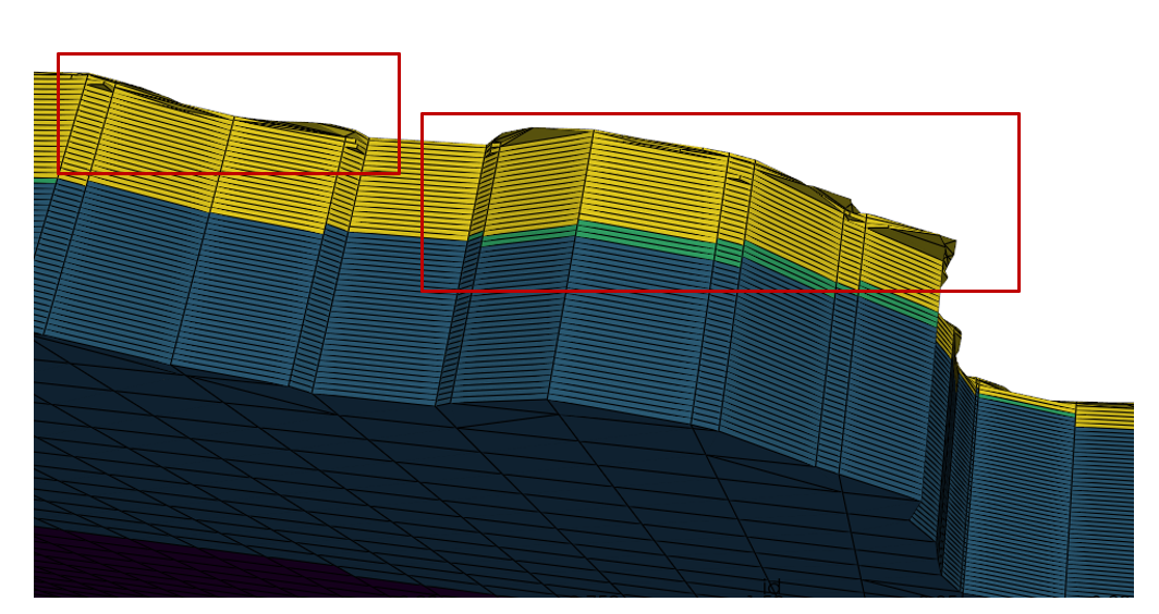

Uneven boundaries clipped by subcatchment shell.
Technical issues arose during the tests: For GemPy models with topography, clipping at the sub-basin boundaries led to irregular outer contours near the surface, which prevented the generation of a valid boundary mesh. The solution was to revert to the original GemPy output format, a voxel grid, and use a two-step clipping procedure: first, the topography, then the lateral sub-basin boundary is clipped separately. The result is a voxel-based model that meets all box requirements and whose boundary mesh can be seamlessly integrated into the subsequent simulation.
