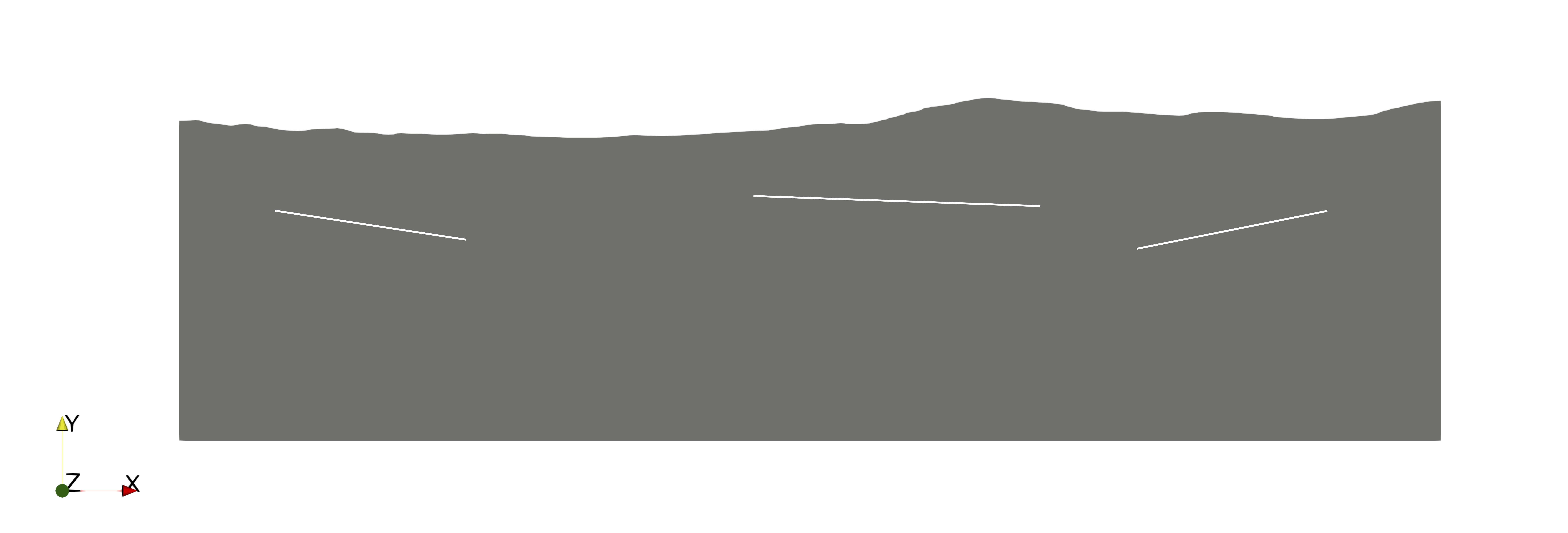

To assess the effect of fractures, a second 2D model incorporated three fracture models as 1D elements and distributed loosely across the domain (see figure on the left). The model depth was extended to 3,000 m below sea level. The matrix was assigned values of 1×10-16 m2 for permeability and 1×10-4 for porosity, whereas the fractures were assigned much higher permeability (1×10-8 m2) and porosity (1×10-3). The resulting temperature contour plot shows that the fractures significantly disrupt the flow field: water enters the fractures and diffuses along them. An increased flow velocity profile is observed, particularly in the central fracture (see figure on the right).
![]() Tromm area in 2D model with fractures. |
